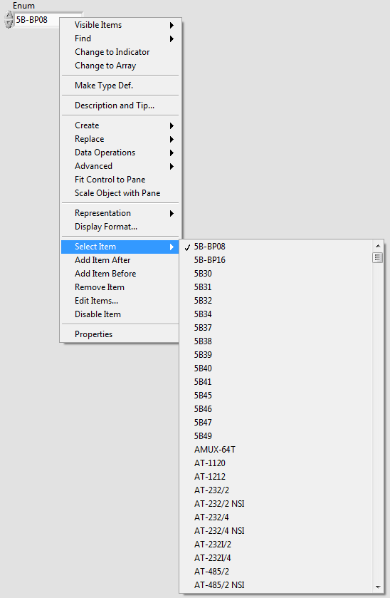

Here's an enum with a lot of elements:
The enum has a built-in right-click menu to 'Select Item', but it's worthless... it does exactly the same thing as clicking on the enum directly:
I think we should replace the 'Select Item' right-click on enums and rings with a Quick Drop-like UI that lets you filter the enum/ring contents and select an item without having to scroll a giant list:

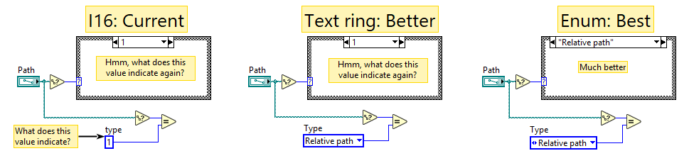

Change the Path Type function output from a signed 16-bit integer to a text ring or enum to aid immediate readability of code and save having to look at the help file:
LabVIEW_2018-11-05_09-16-13.pngThe Path Type function returns a signed 16-bit integer indicating the following 3 types of paths.
0: Absolute path
1: Relative path
2: <Not A Path>
Unhelpful context help.Unhelpful context help.
Text ring would have the least impact on existing primatives: https://forums.ni.com/t5/LabVIEW-Idea-Exchange/Path-Type-Function-needs-another-return-for-an-empty-path/idc-p/2588549/highlight/true#M25086
