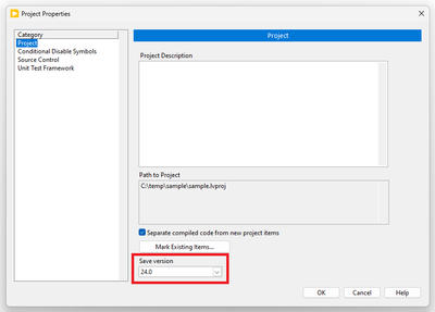

NI had a change of heart. 🙂 This feature is available in LabVIEW 2024 Q3 and later as the Project Save Version feature:
I'd like the ability to set the target version of LabVIEW when I use the Save, Save All, etc commands.
A similar idea exists here: LabVIEW Compatibility Modes, but that idea focuses on retaining the existing version of a VI when it is opened, assuming no newer-LV-version-requiring changes are made.
I'd like to (additionally/instead) be able to choose from a dialog box/enum/etc which version my saves should target (older than the current version of LabVIEW I'm using).
Essentially, this is just the Save for Previous as a possible default save (with the default target being the current version). Since you can't Save for Previous on top of the code you have in memory, I think it would be nice to have this option.
