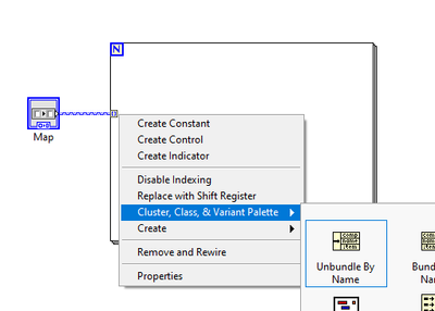

In LabVIEW 2022 Q3, the right-click menu for the map auto-indexing tunnel includes the Cluster, Class & Variant palette:Christina_R_0-1664569121524.png

Maps auto-index just like an Array of Clusters, but the tunnels do not offer the same right-click options. It is not recognised as a cluster:
Right clicking an array of clusters auto-indexing tunnelRight clicking an array of clusters auto-indexing tunnel
Right clicking a map auto-indexing tunnelRight clicking a map auto-indexing tunnel
Hence it is not so easy to place an Unbundle node.
I would love LabVIEW to treat right-clicking on a Map's auto-Index tunnel in the same way as it does right-clicking on that of an Array of Clusters, so then it is easy to choose the appropriate Unbundle node.

Status changed to: In Development
Christina Rogers
Principal Product Owner, LabVIEW R&D
Christina_R
Active Participant
Status changed to: Completed
