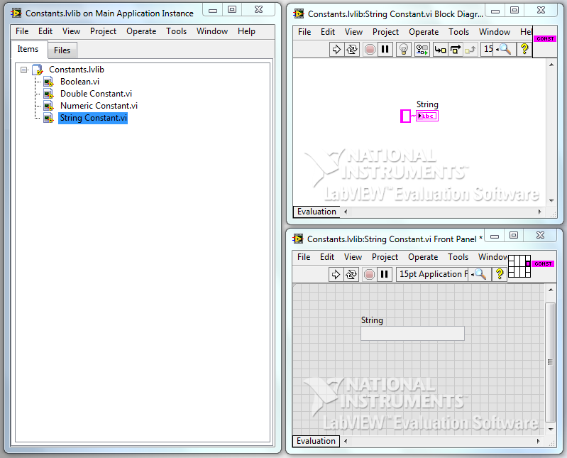

This means that using ‘constants’ in a program should be limited to ‘True Constants’ and ‘Variable Constants’ should either be wrapped in a vi or loaded from a configuration file.
Wrapping a constant in a vi and adding all your applications’ constants to the project makes them easy to manage and change if needed.
I have created a library which I will add to all my projects. This library will then be used as a template for the most common constants used in an application. I then make copies of each as needed, name them ‘xxx_constant.vi’ and use a comment in the application to indicate what the constant does.
I have tried to keep the icon colour the same as the default wire colour for each type making reading the application easier. You can get a copy of my library here if you want to have a look at it or use it.
