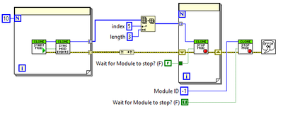

We have identified that, if multiple clonable module instances are executed and a specific module (e.g. the first launched module) is stopped (no waiting) and afterward all open modules are stopped at once (incl. wait) the "stop module.vi" an error 1 is returning.
Steps to reproduce
  1. Create a project and add a new clonable module
  2. Create a tester VI and implement the code above
  3. Run the VI and see error 1 at second Stop Module.

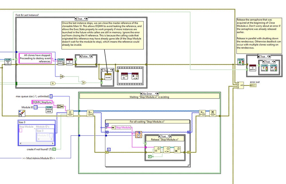

What is happening in the Background
Situation 1 - "Stall Data Flow" = 0
  1. "Stop Module.vi" 2 runs into "Wait on Stop Sync.vi" and synchronizes stop over rendezvous.
    The acquired rendezvous size is 3 (Module 1 which is at stopping, Module 2 and Stop Module)
  2. Module 1 is waiting in "Safe to Destroy Refnums.vi"
  3. Module 2 runs into "Close Module.vi"
    1. Last clone instance is fire at (1)
    2. Releasing the Semaphore (2) will wake up module 1 that it is now safe to destroy refnums now.
      Module 2 runs into "Wait on Stop Sync.vi" (3) and synchronizes over rendezvous.
    3. "Stop Module.vi" and Module 2 waiting for a third participation to join the rendezvous.
    4. Module executes case to destroy Master reference.... and executes "Wait on Stop Sync.vi" (3) with no synchronization as the boolean "Wait for Module to stop?" is on false.
    5. Module 1 executes "Destroy Sync Refnums.vi" (4) and is destroying the rendezvous.
    6. Module 2 and "Stop Module.vi" will be release from the waiting of the rendezvous as the reference is now invalid and returning error 1.
Situation 2 - "Stall Data Flow" = e.g. 2000ms
  1. In compare to the situation 1 the first module is already removed here. The obtained rendezvous has the expected size of 2.
  2. When module 2 enters rendezvous synchronization in "Wait on Stop Sync.vi" (3) the expected amount of participant is reached, and the execution can continue.
  3. In most of our tests, this situation worked fine and did not create an error.
  4. For some situation, we had the behavior that shutdown of the first module seems to be faster as the wake-up from rendezvous of the second module. The module main of module 2 opened and showed error 1. Module 1 seems to destroy the references to early.
Situation 3 - First Module will be stopped with last "Stop Module.vi" call
The shutdown of a module is for this scenario delayed (add a wait 1000ms to exit case of the module)
  1. Stop Module 2 waits for 11 rendezvous participations. (10 module and itself)
  2. One of the previously closed module will destroy the synchronization events and makes the rendezvous reference invalid. => Error 1 at "Stop Module.vi"

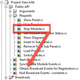

IMHO, it would make more sense to have the Stop Module request at the same level than Start and Sync functions.
