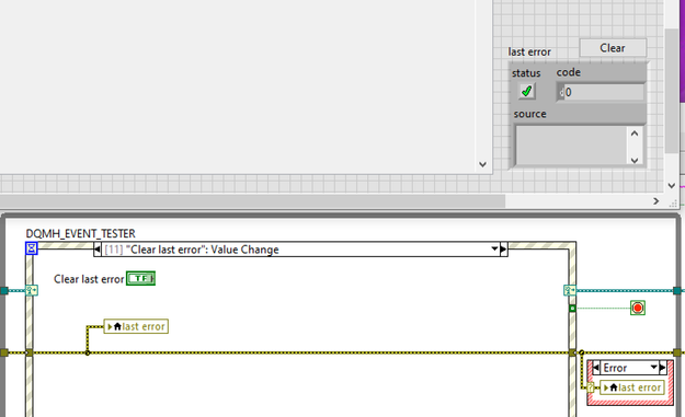

When using the API Tester to, well, test my module, and an error occurs, I always would like to be able to clear the error indicator before moving on - just to make my life easier by being able to see clearly when new, further errors occur.
Like this:
Is there anything at all speaking against adding this nifty little feature? 
