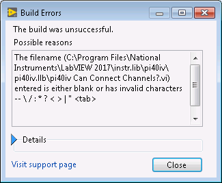

NI LabVIEW allows VIs with invalid characters such as "?" in the filename inside an LLB file as shown below:
However when it comes to building a Source Distribution / TestStand Deployment that uses this file it returns an error as shown below:
This inconsistency within LabVIEW is quite frustrating where one part allows invalid characters in the filename and another part will return an error. Since the invalid characters are allowed in VI filenames within LLB files I would suggest that the LabVIEW build tools also handle them graciously.
During the build process it could quite easily rename the file "pi40iv Can Connect Channel?.vi" to "pi40iv Can Connect Channel_.vi"  and link the VIs that use it to the newly renamed file. The build tools already contain the ability to rename files by adding prefixes so something like this would not be that difficult.
While people may argue to just rename the filename within the LLB and be done with it, the fact that the LLB is a perfectly valid file in the Development Environment but causes problems when trying to do a build is a problem that should be rectified.
The LLB in question is one that is not developed by us but is part of a Pickering Driver Installation obtained from the following location:
http://downloads.pickeringtest.info/downloads/drivers/IVI/
Therefore every time we install a new version of the driver we would need to rename the VI filename within the LLB file.

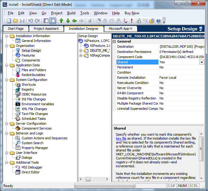

With Application Builder installers there is no way to flag a file as a 'shared' component in the build specification.  This feature is used in MSI installation when files are shared or common among multiple product installers; for example, the files located in \National Instruments\Shared are common dependencies for NI products or in LabVIEW-built EXEs this could be a shared dependency between two applications, like a DLL.  Currently, if two product installers built in Application Builder install the same file, when either of these products is later removed the shared dependency goes with it and the second product is broken!
Some good news is you can use MSI editors like InstallShield to edit the MSI after creating it with Application Builder in order to enable a tag/setting for your shared files:
There are also open source MSI editors available, like Inst Edit, with similar options for tagging files as shared components.
What can be done in Application Builder?
Could an option be added to 'Source File Settings' to tag files as 'Shared' so a third-party MSI editor is no longer necessary?
