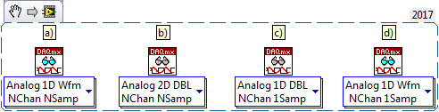

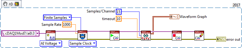

Consider the VI, which of the following is the configuration of DAQmx Read.vi that would result in the data shown in Waveform Graph?

http://zone.ni.com/reference/en-XX/help/370469AD-01/lvdaqmx/mxread/
As we have an integer input “Samples/Channel” and we would like to read 15 samples per channel answer C and D are no valid answers. So we need the NSamp and NChan in the name of the mode(instance). The difference between answer A and B is the output data type. Answer A  gives a waveform data type and B gives a 2 D Array.
So answer A is the correct answer.
Do I am right that B gives the same DAQ measurement values like answer A just in another data type?

Yes, the sample data is the same.  I personally care about all of the timing parameters, so I almost always use the Waveform type outputs.

If we're taking 15 samples at a rate of 1000 samples/s, shouldn't the last data point be located at 0.015s, and not 0.0085s? What am I missing?
Knight of NI
Tiger5hark,
Nice observation.  The last data point should actually be at 14ms (first data point it as time = 0).
Though, it could also be based on the DAQ module used.  It could be that 1kS/s is not possible with the module and the driver rounded the rate to the next highest available rate (~1.65kS/s).  Yet another reason I like to keep with the waveform data type.
