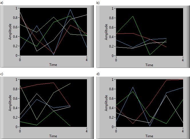

Which of the following Waveform Charts contains data generated by the VI?
Chart, by default, transposes the array. So C.
C. Could have been D in case waveform chart replaced with waveform Graph
Not A and not B (array size 5x5 and 4x4).I would say C and D (array size 4x5 and 5x4).One of them transposed.
As Chart Transpose the Array. Answer is D
c)
WHY?
in case of graph 4*5
but since its chart defaultly transposes array so its 5*4 (5 diff siganls with 4 values each) so its C
C
Answer is C. The Chart show the 4 signals in order to time 0,1,2,3 -> line 1, then repeat for loop 5 to generate 5 lines. It is different with Graph.
it has 4 random variable, so in chart 4 line should be there. then N=5, so its from 1-5 not 0-5. so 5 points should be there. then the answer is D
