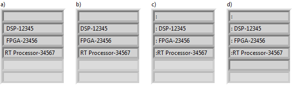

What is String Array Out following execution of the VI?
NOTE:  The UUT Information string constant has been duplicated and is shown in '\' Codes Display format.

Is there supposed to be a difference between C and D?  Because I am not seeing it.
So until I am told otherwise, C and D are the answers.
Nevermind.  I now see the extra empty string at the end of the array in D.  So the answer is C.

C

The empty element doesn't show up that well on my phone either, will increase the size when I get back to the office

C

C

Answer C

c

 Answer: C. Thank you for exercise.

C or D (the colon must be included)
As there is no Linefeed at the end of the duplicated string the
answer should be C.
At a real exam I am not sure if I am able to find out that the first function is a "Spreadsheet String To Array Function". Do we have to know the Symbols/Icons for every function in LabVIEW for the CLAD exam? Or just the Array and string functions? Is there a NI defined subset which function I have to know for the CLAD exam? I guess there is no clear subset and I have to decide which functions are important or not ....

i couldnot understand C and D . Both are looks same

Answer is :C Only, Because D is same value-but empty String is added in Array..Capture.JPG
