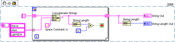

What are the values of String Out and String Length Out following execution of the VI?
NOTE: Inverted commas shown to highlight whitespace, they do not appear in String Out.
a)      <empty string>, 0
b)      “Steve “, 6
c)       “Steve Likes ”, 12
d)      “Steve Likes LabVIEW “, 20
