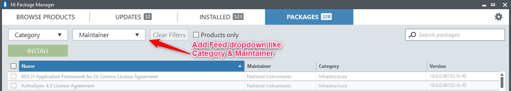

We should be able to filter the Packages displayed by Feed. This would allow users to focus on their internal feeds and find packages quicker. Particularly when basic LabVIEW\TestStand shows 90+ packages (300+ with hidden shown), the drowns out the internal packages. This would allow for more categorization than the Maintainer and limited Categories (improvement idea) afford us currently.
