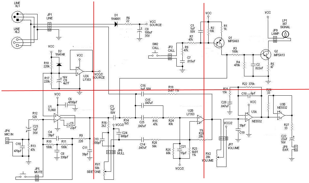

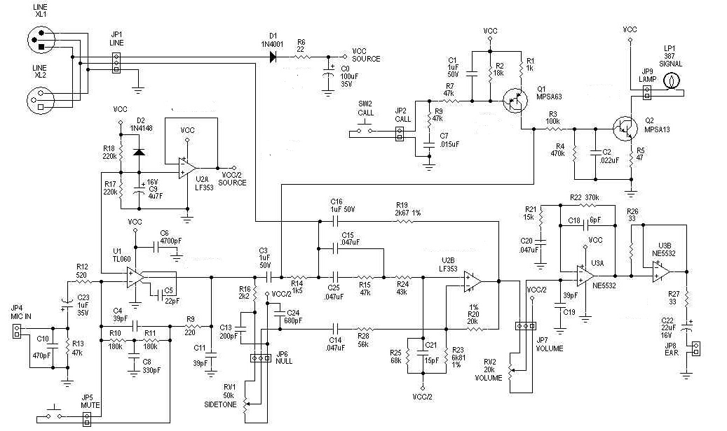

First of all let's take a look at a simple electronic schematic and review cohesion
Cohesion – A measure of how strongly the elements within a module are related. The stronger the better.
Our design task is to break this circuit into printed circuit boards (pcbs).
As a designer we could just split the schema like this and create 6 pcbs.
This is coincidental cohesion and I've seen it's use in LabVIEW by careless use of the Create SubVI function. Signs that you are suffering from this are:-
Lack of re-usable functions : the pcbs can only be used for this type of job.
Difficulty in naming : giving each pcb a name and purpose is difficult.
Difficulty testing : the pcbs can only really be tested when fully assembled.
We can easily improve the design by breaking out the functions of each pcb (functional cohesion). Here's a reasonable effort.
As a bonus we can see that the amount of inputs and outputs has been reduced. So improving cohesion also improves coupling too.

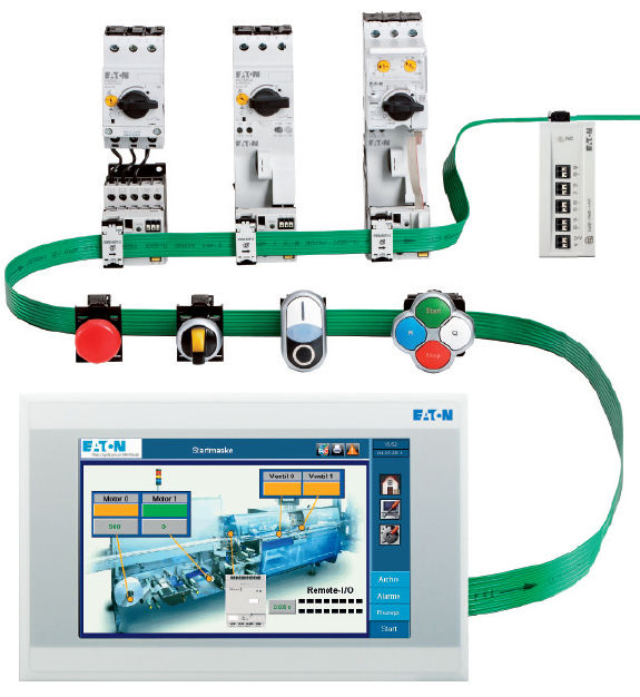

This Eaton PLC system illustrates what we call component design quite nicely I think*.
Each component in the system has a messaging system connecting everything together, each is a discrete component. The communications interface (SmartWireDT) allows additional features to be easily integrated.

If you describe the extremes of coupling (loosely, tightly) followed by a sentence like: "This Eaton PLC system illustrates it quite nicely I think.". things become very ambiguous because we cannot tell which kind of coupling you are trying to illustrate with "it".
Active Participant
Can't say as I disagree Christian, I'll edit it in the next couple of days to clarify and expand the point.
