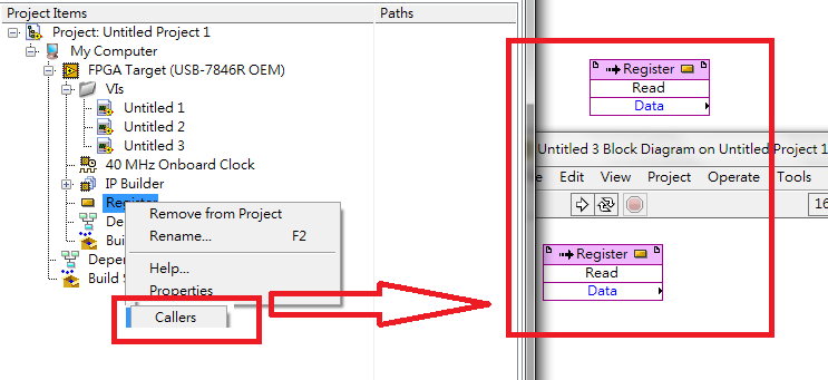

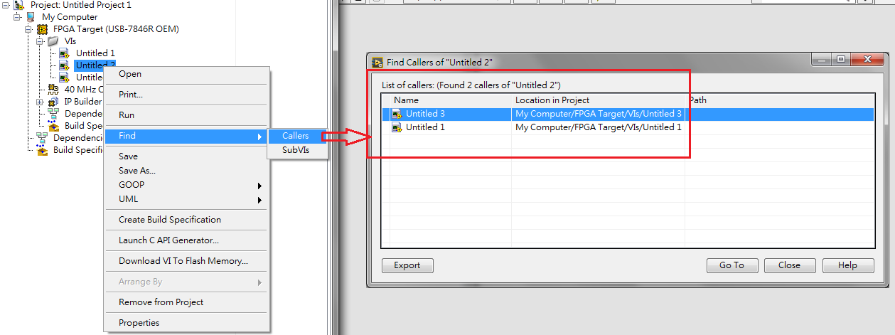

I hope the FPGA Register Function Could Add "Find Caller"....
