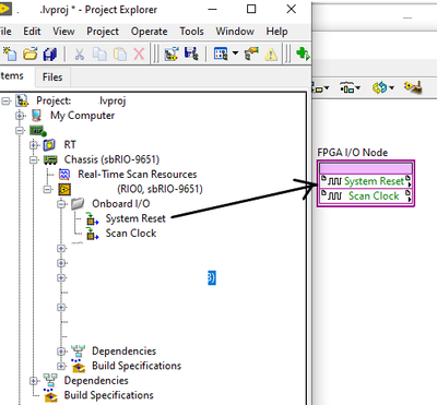

When dragging multiple IO items from project to a block diagram, it'd be great to have them show up as a single IO node instead of multiple ones. To be backward compatible it could be something like <Shift>-drag. This improves code readibility by producing more compact code.

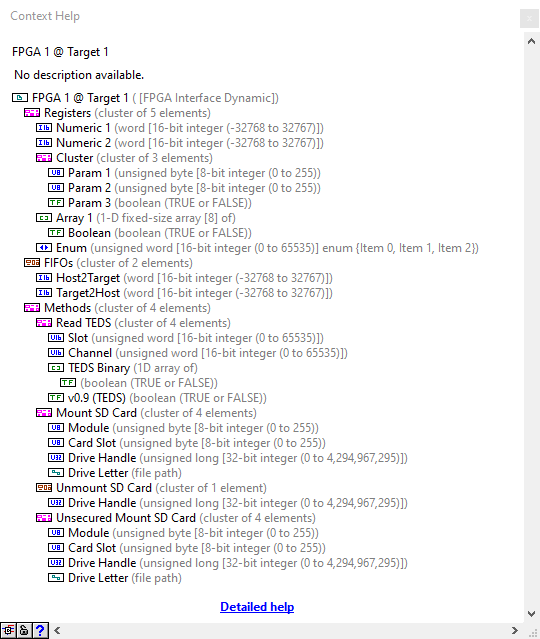

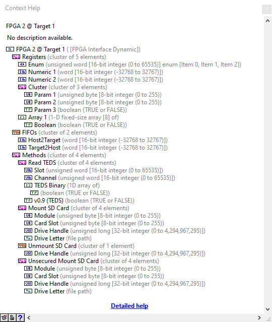

I recently have issue configuring FPGA Vis to be run seemlessy by the same host code, because of incompatible interface between VIs. Here is the Configure FPGA VI Reference Interface :
Configure FPGA VI Reference InterfaceConfigure FPGA VI Reference Interface
And here are two (differents) interface, fore FPGA 1.vi and FPGA 2.vi respectively, as seen in the context help. I just duplicate the VI for the example and get the tab order modified - see under Registers :
Context Help for FPVA 1.viContext Help for FPVA 1.viContext Help for FPVA 2.viContext Help for FPVA 2.vi
I think it could be more consistent to have the same kind of display in the configure dialog, with the same control order. It's quite confusing not seeing any difference when configuring a reference to discover that something is wrong at run-time (controls and indicators are separated, and then sorted alphabetically - I only set controls in my example code, no indicators). The context help over the dynamic reference finally helps me to figure out what was wrong but it tokk me a while...
Please note that the FPGA FIFOs have to be define if the same order from one bitfile to an other (if there is differents targets, or differents projects). This is correctly reflected by the configuration window.
So I suggest having a more coherent display of control and indicators interfaces, that correspond to the effective interface (just like the context help does), i.e. the tab order of the controls under Registers.

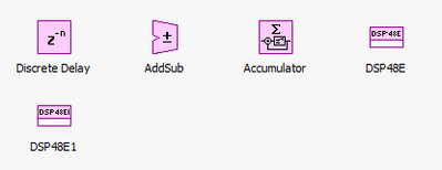

We're starting development on an Ultrascale device, KU40 and am missing the option to utilise the DSP48E2 primitive as we have for DSP48 and DSP48E1.
NXG seemed to have it, but as we all know, NXG is no more.
https://www.ni.com/docs/en-US/bundle/labview-nxg-fpga-module-cdl-api-ref/page/dsp48e2.html
Can we please have a DSP48E2 primitive for LabVIEW FPGA? I would really like access to the new features supported, including the wider multiplier.

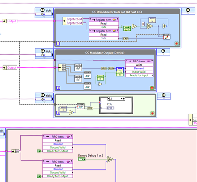

I would like to show some pertinent information to the configuration of certain primitives in FPGA code.
The ability to turn this display on and off just like a label would be very welcome indeed. I'd always have it visible.
I just spent two days tracking down a bug which ended up being an under-dimensioned Block RAM instantiation (and how BRAM indexing works, just throwing bits away instead of coercing the read/write index), something whose configuration is completely hidden from view. Why can't we have some visible elements to show the size of a Block RAM and the Datatype (FXP would do for any given FXP type). Same goes for FIFOs, whether a FIFO is 16 elements or 8192 elements deep is a very important piece of information. And of course I mean only the primitives which instantiate the resources, not FP references for these items, even though the datatype of these would also be a very welcome addition.

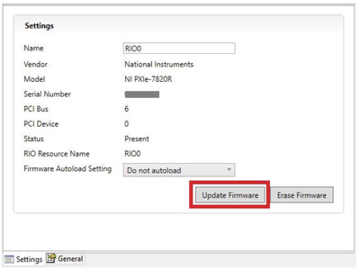

The functionality of the update firmware button on NI MAX (R series targets) is not clearly described on NI documentation:
It would be nice to add a description of its functionality in the LabVIEW FPGA Module Help document.
