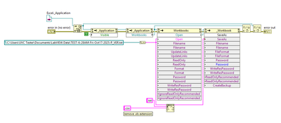

My intention with the following:
Open a text file as a CSV:
Then save the CSV
Result opens in memory as a CSV... Actual saved file is not in the CSV format.

Did you not like the solutions you already got?
