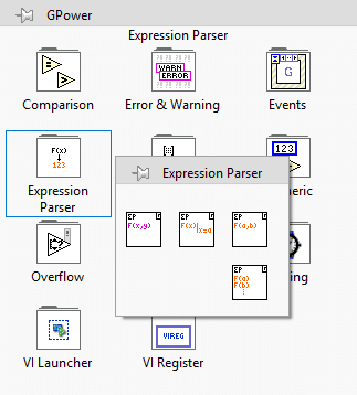

There are plenty of restrictions that I am willing to accept if it means I can do things like allow a customer to design their own transfer function in a legitimate programming language. Seriously.

Additionally Tyale the problem you refer with having a text implementation of a transfer function has been solved by us at GPower, have a look here https://gpower.io/products/gpower-expression-parser/?lang=en
