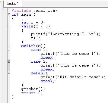

Hi AfgVD,
Thanks for your post! I think I understand what you're looking for but just to be sure, in addition to being able to collapse the switch statement itself, you want to be able to close all of the cases themselves, is this correct?
So from this:
To this:case_close.png

hi,
Yes it is exactly that
