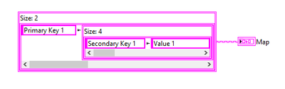

Currently, non default map constants (like the one shown below) are detected as fatal insanities when deploying to Real-Time targets and crash the LabVIEW development environment.

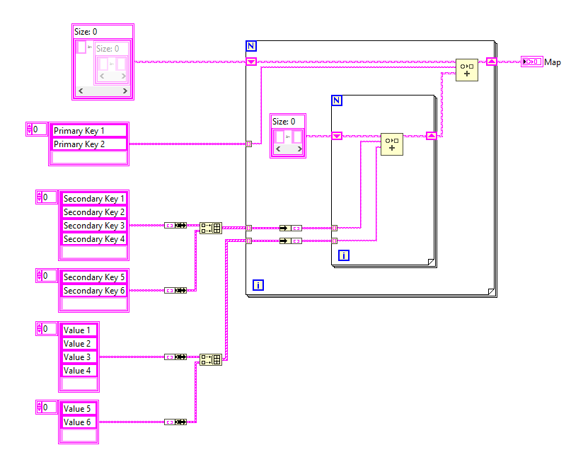

There is a workaround, which is to build the map from other data structure constants. The map constant above was built from the code below. However, it takes longer to execute, and it takes more code. That is okay in some cases, but it would be better if there was an option to simply use the map constant above.
