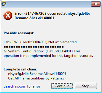

Second comment on TomOrr0w's very informative comment:  In MAX, I can find my Cameras, and can give them "Friendly" names (by right-clicking and choosing "Rename").  First, I get the Devices & Chassis "Product Name", which returns the name MAX displays as the "unchangable" Camera Name.  I also get the Expert Info:Alias property, which gives me the "Friendly" name, the one MAX lets you change.  However, I can't figure out how to (programmatically) change it -- as a Property Node, it is Read-Only, and there are no Methods available for the System Hardware reference.  So we have some of the functionality that MAX can exploit, but not all of it.  I suspect that this may involve manipulating the Camera's .iid file and setting the "interface name" Property.  Do-able, but it would be "nice" if such details could be wrapped up into an NI-supplied function ...

The System Configuration API does support changing Aliases (System Configuration -> Hardware -> Rename).  However that functionality appears to not be supported in IMAQdx.
