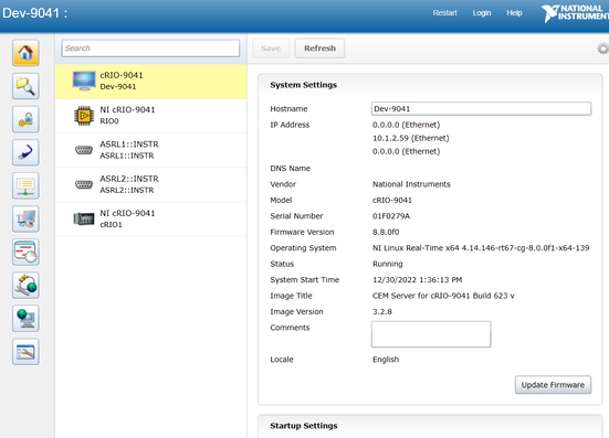

Just to illustrate the two interfaces for those who have not seen the new one yet:
We went from this quite useful and nice looking GUI:
to this 1990s (70s?) non-functional one:
Why? LabVIEW is for graphically oriented people...This is sad even for the text lovers 😉
