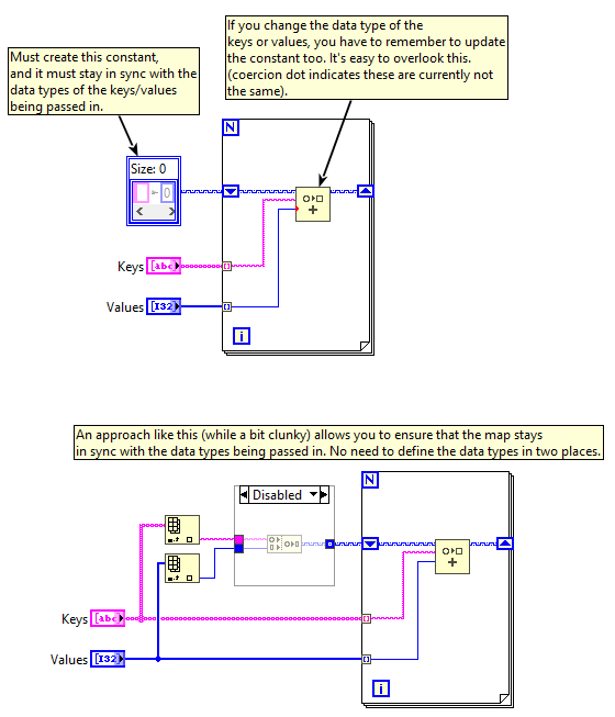

I find the process of initializing Maps in LabVIEW to be unintuitive and inconsistent with the initialization process for other similar concepts (such as, say, arrays).  After some initial trial and error, the process I've settled into for creating maps is to drop a map constant, and then to drag and drop the appropriate data types onto it for my key and value. I first looked for an Initialize Map VI (which doesn't exist) and then tried to create the constant by wiring up appropriate types to an "Insert Into Map" and creating the constant from there -- but this doesn't work as expected because the terminals don't update appropriately.
What drove me to coming to the forum today though, was that in creating a malleable VI with a map inside of it, I found a breaking point for the "drop constant and drag values into it" approach. Since the map data types need to be dynamic to support malleable VIs, I've had to get creative to get around that...

Not exactly.  A dynamic initialize VI allows you to avoid defining data types twice, which is valuable in a normal VI.  If the type of value data gets updated, I currently also have to update the data type of the constant.  Typically this is just an annoyance because it will break a wire and I'll be alerted to the issue.  However, if the data types can be converted to one another, then there won't be a broken wire and I may be inadvertently converting data when storing it into the map (which could be a painful-to-track-down bug).

Carl, can you provide a picture of this scenario? The only situations that sound like what you're asking for that I could envision are all solved by creating a typedef of the map, and I'm confident that isn't what you were suggesting. So I need more context to understand, please.

@AristosQueue, here's an example of what I was thinking:

I see what you're talking about. That's not really equivalent to "Initialize Array"... that's just "give me an empty map of these types". The comparison to Init Array sent my brain down the wrong rabbit hole because initialize is about reserving space in the array data structure for later manipulation, which is why I said there's no equivalent. But you make a good demonstration on a use for "Empty Map" VIM. Likewise, "Empty Set". Thanks for the feedback. I'll update backlog notes.
(Tangent: In your picture, I assume that's your code today. You likely want to move those Index Array nodes inside the diag disable structure... they're just as much dead weight, but compiler will still generate code for them unless you've turned off debugging on that VI.)
