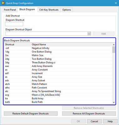

All available (user configured) QD shortcuts for the G-Objects,

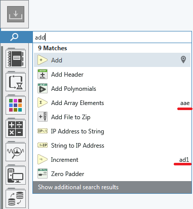

This Idea quick drop shortcut context help was implemented in LabVIEW NXG as below,
NXG Quick Drop Search WindowNXG Quick Drop Search Window
It shows the QD shortcut for the listed objects.

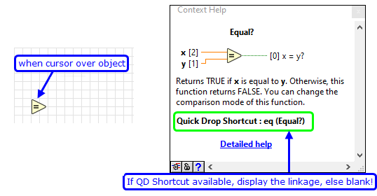

But what we actually expect is, even without QD is open, if we hover over any object, Context Help updates its contents, in addition to that - if QD shortcut is available for that object, show them too.
Expected Context Help Window BehaviorExpected Context Help Window Behavior
