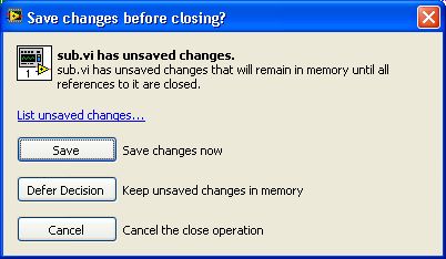

Well... more or less... before LV8, for all the subVIs you closed and clicked "don't save" you had a "save subVI window" when closing the main VI.
Now just one window comes asking you to select subVIs you want to save in a list. And that list is as long as thenumber of subVIs with unsaved modifications... well done to those who will remember when they close Smiley Very Happy

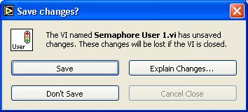

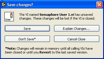

@ Ray Farmer
This is what it looks like if you delete a changed subvi from memory
cheers
David
Message Edited by David Crawford on 09-20-2006 03:00 PM
Message 46 of 85
(6,324 Views)
Isn't that the same as previous version?
Regards
Ray Farmer
Message 47 of 85
(6,322 Views)
@TiTou wrote:
... What I was used to do is to close subVIs and decide right away to save or not changes, so when at the end the dialog came I would say "don't save subVIs".
And the possibility to differ the save for when I close everything really seems useless to me ; but this because of the way I am used to work 😉
But you can still do that. At least 8.2 (and I assume 8.0 as well) has a Don't Save - All button (if the check box under it is checked) which is functionally identical to Don't Save SubVIs.
I agree that Don't Save SubVIs is more easily understood (at least for us who know it), but Defer Decision is definitely more Accurate than the Don't Save we used to have since the VI (with its changes) was still in memory.
The problems I do have with the new dialog is that the Affected Items area is useless (The VIs are displayed in several columns, which is unreadable) and that
List Unsaved Changes is for some reason displayed as a hyperlink instead of button (what is that good for?). I think whoever wrote this window had the same feeling about the Items area because they supplied an option to hide it (the small triangle).
If you do actually click the "link", you will see that the Explain Changes dialog is not very useful either. I think that this should all be a single (resizable) dialog which would allow us to select all the items we want to save from the list and not to have perform the same function on all the VIs or on a single VI at a time.

Ray, its this dialog that TiTou had a pop at.
These are the old Save Changes dialogs in 7.1 depending on whether you close the subvi or delete from memory.
cheers
David
Message Edited by David Crawford on 09-20-2006 03:26 PM

Am I the only one confused by
Defer Decision:  Keep unsaved changes in memory
What the heck does that mean?  If I don't want to save it why would I want to keep unsaved changes in memory?  To do what?
I dunno... I'm confused..  Maybe it's a French thing..  Maybe TiTou & I should read it backwards..  😉
Tenir les changement non-sauvegarder en memoire...    hein???
Let's see... I don't want to save the last changes, and I want to close the VI..  What are my choices?
1.  Save   (I don't want to do this.  I want to discard my changes)
2.  Defer Decision  (Keep unsaved changes in memory.  I don't want to save any changes.  I simply want to close the vi or quit.. This sounds scary!)
3. Cancel  (Oh NO!!  After all this trouble... I'll be back at square one!... So.. I certainly don't want # 1.. And not # 3.  Do I tempt fate and click on # 2 ?)
2 it is..
What now??  It told me that the unsaved changes are still in memory..  Can I turn off the PC now?  Will it blow up??  OK it's safe... It's not a DELL!
Looks like we're on the verge of insanity.. 😉
Should I even be posting this??  They'll send me to an asylum (hope I spelled right).
Here goes...
Submit Post  (after all that's a lot of typing... wonder if anyone actually read it)
