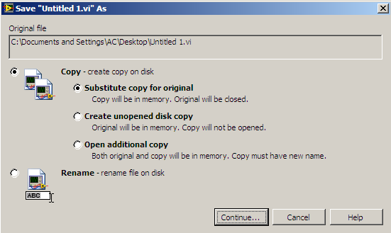

there is a different way to do this
File >> Save as, and you get this :
This is a cool new feature I think
