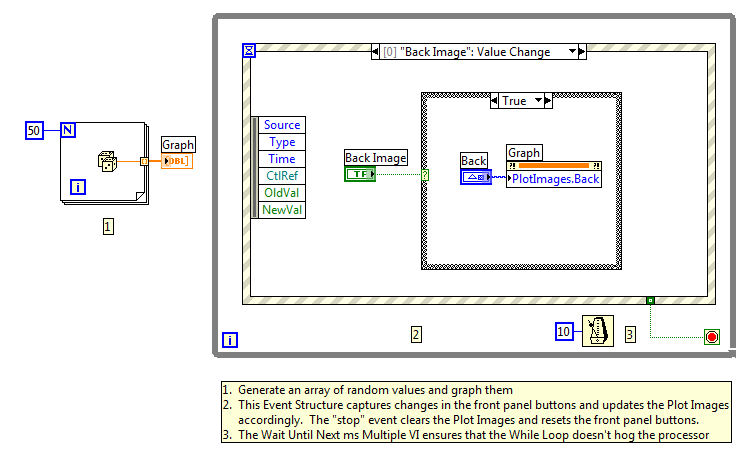

Plot Images.vi found with the example finder is not exactly an RG but there is some pointless code.
Spoiler
I am guessing this was originally written before LabVIEW had the event structure and #3 was overlooked.

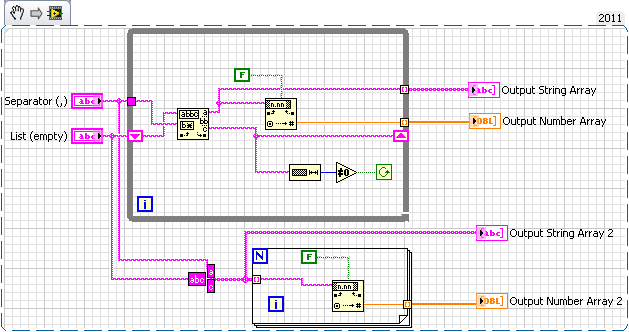

Found in Agilent 34790.Lvlib:List to array
Spoiler
(c) 2005-2010 National Instruments.  ALL RIGHTS RESERVED.
 for whatever its worth I think the string searches in the upper case call the split string function anyway but I won't bother benchmarking either

That "continue if true" is a hint that this is ancient...

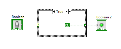

The curious case of the blue booleans!
Is there a reason to temporarily convert booleans to numbers just do do some boolean operations?
To do it just like it was developed in VB.  (If I remember my text programming correctly)
(seen here)
(Of course we would also have e.g. "in range and coerce" to simplify things even more ;))
I've been digging through code tha looks like this for the past month..
Except for the locals..
