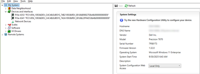

My Dell Precision 7670 recently received a "critical" BIOS upgrade to version 1.21.1. This killed the DMA capability of the Thunderbolt bus, so my PXIe-1090 no longer works correctly. Here is what it looks like in MAX:
Note that the cards have lost their normal names and now have Windows style identifiers. This is the same symptom I saw when I first connected the 1090, before I modified the BIOS to allow DMA over Thunderbolt. The 1090 status lights show a good connection.

Here is a screenshot from MAX with the current info and still showing the issue. Note the missing PXIe rack.
