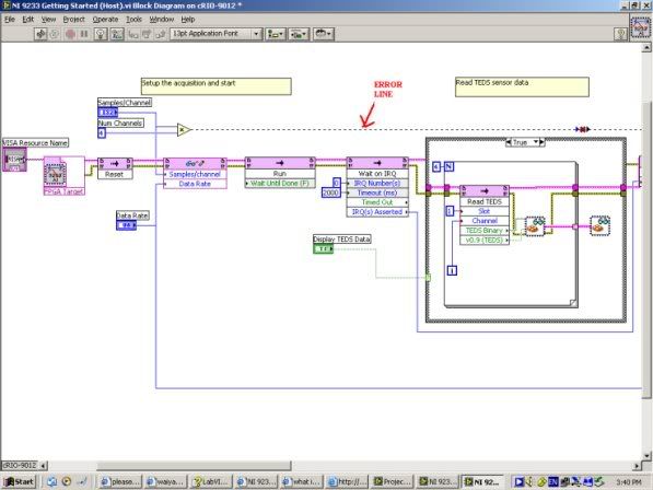

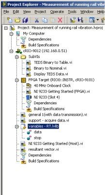

HI ,
       I would like to ask you one more thing , pls refer to the following that is our viproj .. is it like what you ask to do ?
if yes, there got some errors about wire line like the following in the NI-9233 getting started (host).vi .
and there are errors in the NI 9233 getting started (fpga).vi also.
Thank you so much . i am looking forward you reply .
Message 4 of 10
(3,966 Views)
Why not attach the images to your message as .png files rather than having them hosted on some 3rd party webserver?  They are rather small and hard to see what's happening with that wire.  It would be best if you posted the .vi as well.
It looks like you have a mismatched datatype.  You have some sort of integer value (the blue wire coming out of the multiplication) trying to go into a terminal of a different type.  It's hard to tell because it is cutoff in your screenshot and it is reduced so small, I can't make out the color of that wire.
If you turn on Context Help and hover your mouse over that wire, it will give you some details as to what the wires are and why they won't connect.  As well as clicking on the broken run arrow at the top of the VI.
Message 5 of 10
(3,942 Views)
Hi roxylat,
I would like to also suggest that you follow RavensFan's recommendations.  His tips will definitely help the community support you!
By FPGA VI I was referring to the VI that is actually compiled to the FPGA.  So you are correct that I mean the "NI 9233 getting started (fgpa).vi"
Brian A.
Applications Engineer
Message 6 of 10
(3,915 Views)
