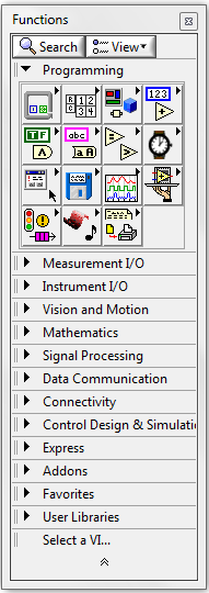

How can I modify my control palette permanently?
I would like to do this for the front panel as well as block diagram.
Currently, if I bring up the palette, this is what pops up
I would like the palette to show the progamming window by default,
as much as I love the express palette Smiley Very Happy

I never change them myself but I think
Tools >>> Options >>> Controls/Functions Palettes >>> Foramtting >>> Palette
may be the switch you are looking to find.

You don't change them there but the screen does describe how to change the visible categories by clicking on the View button of the pinned palette.

Yeh, thats how I ended up changing it, but I gave Ben the solution because he got me most of the way there Smiley Happy
Once the palette is open, just pin it down and press View >> Change Visible Catagories
