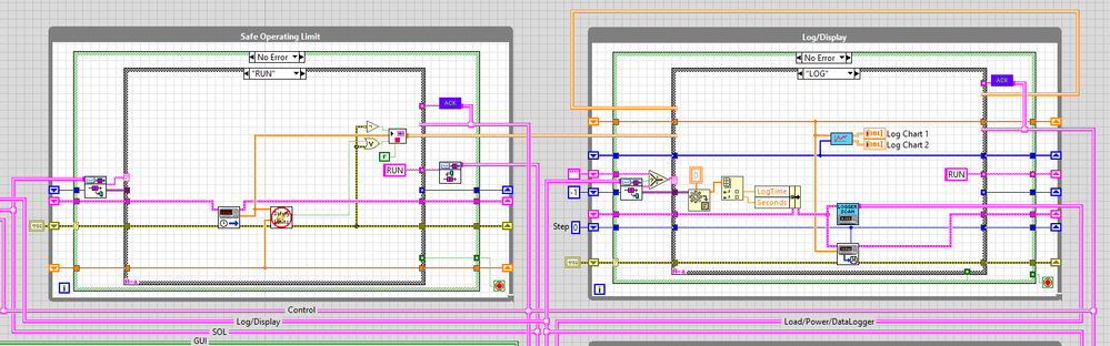

I have implemented pretty much the same thing in my qualification platform. In general there are two ways to do this Queues or Channel Wires, I chose Channel Wires and a Channeled Message Handler program architecture (CMH)
I will try to explain the two loops that handle this Safe Operating Limit (SOL) and Log/Display loop.
The SOL loop is constantly taking measurements of all input and output conditions. Compares them to the safe operating limits, and places every measurement into a Channel Wire
The Log/Display reads each measurement from the channel wire, displays, places if into an array, and places it into a "lossy" Channel Wire that loops back into the Log/Display loop. I calculated the size of this Channel Wire (buffer) using the sample rate of the power analyzer taking measurements to hold enough readings for about 10 seconds prior to the SOL trip. Channel Wires and Queues are FIFO so it always holds about the last 10 seconds of measurements.
When the Log Interval timer expires the Min Control loop tells the Lod/Display loop to write the most current measurement to disk
If certain conditions (Input Current in most cases) is higher that the limit for longer than a certain duration (to prevent inrush tripping SOL) then the SOL loop send an Error using a custom error code to the Main Control Loop.  The main Control loop then tells the Log/Display loop to dump the buffer to the end of the data file, shuts down all input power to the UUT, and halts the test.
