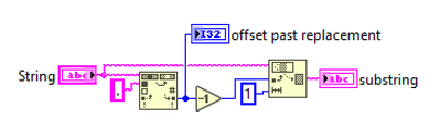

I'm trying to find a way to differentiate duplicates of files based off of their revision. Two files are the same but of different revision if they have the same file name, but a different suffix (always a capital letter) at the end.
For instance:
ABC123A.xxx
ABC123B.xxx
are both of the same file but of a different revision.
ABC122A.xxx
ABC123B.xxx
are of different files and different revisions.
My problem is that I need to be able to determine if two files are the same but of different revisions. My idea for a solution was to strip the file extension, then split the remaining string into two, one being n-1 characters long, and the other being 1 character long. Is there a way to do this? All split string methods I've seen so far either require a complete match or a delimiter.

Use "String Subset"

Search and Replace string to find the location of your period (start of your file extension), decremented to get the rev digit, and fed into string subset of length 1 to pull out the character of interest.
