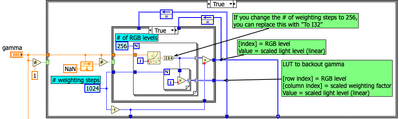

@altenbach wrote:
Nitpicking: To remove some diagram clutter, all we need is a single "1" diagram constant the the "3" can be left unwired. 😄
I also doubt that the "delete from array adds any value, because the deleted element is probably zero.
Oh, I know about this, but sometimes leaving these constants connected (this time the code was quickly copy-pasted just to prove the improvement). In some cases, unwired inputs on array operations can be a kind of indirect "obfuscation", and in this special case, the "3" here indicated (for stupid code reviewer) that the next loop will iterate 3 times.

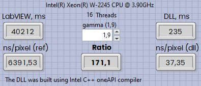

and 'More lookup, less multiply' does the job. When compiled under the Intel OneAPI C++ compiler, it is more than fifty times faster in comparison to the pure LabVIEW code.:
The screenshot above from LabVIEW 2024Q1. If we will take old LabVIEW 2018 32-bit, then performance boost much more significant:
The source code is attached. There are two benchmarks inside — one for the Intel OneAPI C++-compiled DLL and another one for the Microsoft C++ Compiler. If you don't want to install the Intel Runtime, you can play with MSVC (which is around 20 times faster). I checked twice that the debugging is disabled, code is inlined, etc.

Well, I couldn't leave well-enough alone.
I wanted to have it use a variant of altenbach's much faster method in cases when the gamma is set to 1.
But something strange is happening.  When the gamma is set to 1, this default case doesn't execute (which is correct).
But the mere presence of code in that (unexecuted) case slows it down a lot. If I delete the code in that case, it runs much faster.
Why is it that the presence of code in an unexecuted case slows down the vi?

Well, the only NI can tell you "why". LabVIEW is an optimizing compiler. This means that some optimization steps are internally applied to get "optimal" code, such as constant folding, unused code removal, etc. The code is also split into chunks that can be executed in parallel, then threads are created, and so on. After that, LLVM comes into play, and in the end, the overall execution internally is not as shown on the block diagram. In this particular case, some unnecessary code is definitely executed in the background. The question is — where exactly did the compiler place the "branch" that will switch between the two execution paths?
Anyway, after some experiments, I've found that removing this wire is a game-changer — if it's removed, then the code will run as fast as without the case structure.
Probably Shift register causing a problem.
Then obviously you can modify your code to run without gamma as shown, this is your "false" case and the constant moved from upper case to lower, leave output unwired:
And the true case:
Then it works as expected.
Interesting case, good to know, thanks for catching this "issue".
