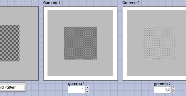

By the way your new algorithm produces slightly different result than the old one (at least comparizon not equal, somethig may be wrong with rounding), and more slow than the previous (rougly 20% on my PC - 120 ms vs 100 ms before when 256x256 image scaled by factor 0,9):
Anyway, I checked this with checkerboard and test image, and now I see effect of the gamma (on the screenshot it may wrong appear if scaled in browser), this is gamma 2,2 and scale factor 0,9:
and regular image looks normal with such gamma, at least visually:
So, you're on the right way.
