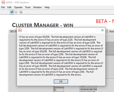

I have build an application that run fine in the development environment, and also runs fine as an application. I haven't yet implemented shutting down the front panel when it stops as it is sometimes handy to restart the application. However a curious thing happened the the most recent build... after the application stops the run arrow turns broken. It runs fine when launched if not open already, but then has a broken run arrow after running. Clicking on the run arrow gives this:
Regarding the suggestions here for error 2208, the appropriate runtime is installed, I have .NET 4.8 which is the newest recommended version, and I just recently upgraded to LV2023Q1. The other errors all seem to also be related to LVRT engine revisions.

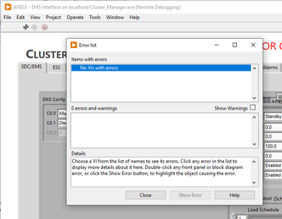

Running the application debug utility, and then opening the Error list shows no VI's with errors.

Issue turned out to be a broken class due to file path being too long (similar: https://forums.ni.com/t5/LabVIEW/Get-LV-Class-Default-Value-Error-1498/td-p/1129973), causing an error when launching an Actor... this in combination with not handling this error properly likely caused the launching Actor to hang and blocked access to required vis. Shortening the name of my exe file fixed the problem.
