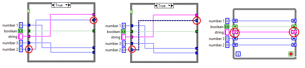

In "Case Structure", when we use "Linked Input Tunnel" and select one end of the tunnel, is it possible to highlight the opposite end? as is the case with "Shift Register".
case.pngWe have crossed the wires on purpose, because it isn`t always possible to make a straight line.

I've written a right-click plugin to provide this functionality. You can get it here:
https://forums.ni.com/t5/LabVIEW-Shortcut-Menu-Plug-Ins/Highlight-Linked-Tunnel-llb/ta-p/3799411
Let me know if y'all think this plugin should ship with a future LabVIEW release.

For shift registers this selection means both will be deleted when you select one. That makes perfect sense.
For tunnels, if both are selected automatically, does that mean both get deleted? Not sure if I'd want that. An indication of the relation would be nice, but automatic selection might not be ideal.
A QD or RC might be a good final solution.
