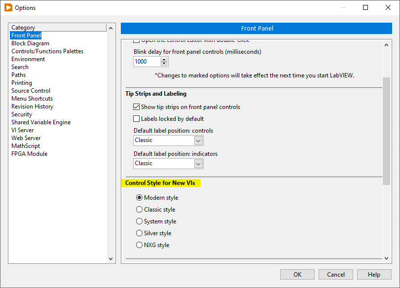

I am aware that one can create 'fresh' controls and indicators in another style matching the type and wire them up, or one can right click on the controls and indicators and replace them with a different style of the same type (although this isn't guaranteed to have the same appearance as dropping them fresh, as it may inherit modifications made to the control/indicator and other properties), but it would be handy to have a quick way of creating 'fresh' controls and indicators in the style chosen under Tools>Options>Front Panel>Control Style for New VIs .

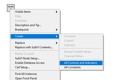

Current behaviour: 'create (all) controls and indicators' applied to a subVI creates them in the style of the subVI
You can see that my 'silver' subVI creates silver controls on calling VI.

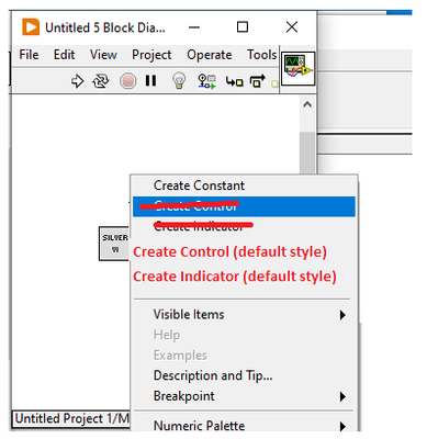

Desired Behaviour - If ini key to modify existing behaviour is applied (e.g. CreatedControlsAndIndicatorsAreDefaultStyle=True), or the VI is selected with shift+right click, the 'create control', 'create indicator' and 'create all controls and indicators' will create using the default style.
e.g.
I *think* when you have System selected, 'Error Out' drops down a Modern error control as there is no System error control, if I understand this correctly. It's worth thinking about cases like this.
When applied to my example above, if my default was modern, the subVI's 'Silver' style controls and indicators show as Modern style in the calling VI, and they are 'fresh' rather than converted :
Optional: LabVIEW *could* modify the menu item when you access via ctrl+right click, but this is not essential. I don't think these options should be added to the menu permanently alongside existing options otherwise it gets too cluttered.
