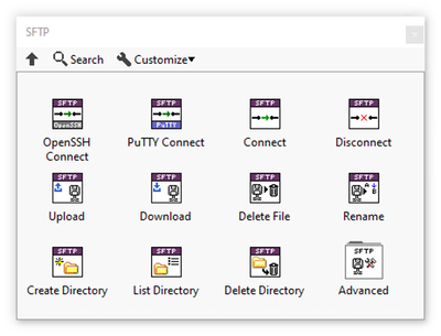

The LabVIEW 2021 Beta includes a new palette for using SFTP.
The attached example shows SFTP upload/download with password and key-based authentication.

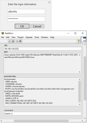

Here's the example from this thread:
And here's the example that ships with LabVIEW 2021:
