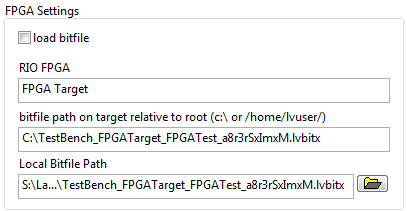

The local bitfile path is S:\LabView\2014 SP1\Test Bench\FPGA Bitfiles\TestBench_FPGATarget_FPGATest_a8r3rSxImxM.lvbitx

This isn't a module I've used myself but here are some of my thoughts.
1. The bitfile path under FPGA settings should be relative to the root folder so I would not think your path is valid. For starters, I would suggest just setting the bitfile path to FPGA file name "TestBench_FPGATarget_FPGATest_a8r3rSxImxM.lvbitx".
2. This is something that I'm not totally sure about but even if you have the FPGA bitfile in flash I believe you will have to check load bitfile so the engine knows about the bitfile.
3. When you use the deploy tool, is the lvbitx being included? This should deploy the bitfile to the "bitfile path" that you specified earlier so I would make sure the deploy tool is including that bitfile and open an FTP connection to verify that the bitfile was deployed to the correct location.

Okay was able to set up a simple test here and dig into the code. It looks like this is a bug that has been reported before and is the result of the target configuration storing the bitfile path as a path type in it's private data rather than as a string. This means that main.lvbitx ends up getting stored as /main.lvbitx and when we build a path with that value as the name/relative path input it results in <Not a Path>.
https://github.com/LabVIEW-DCAF/TagEditorCore/issues/321
Since more people are running into this, I'll see if we can try to get a decent fix although I think the fix would have to involve changing the data type of private data which I'm hoping won't result in other errors.
The good news is that before DCAF attempts to use your path output as a relative path to add on to /home/lvuser, it sees if the bitfile path is a valid file and uses that if it is. This means if you change the "bitfile path on target relative to root" to the full path /home/lvuser/main.lvbitx, it should be able to load that correctly.

I would recommend keeping the path "home:\lvuser\main.lvbitx" even if it doesn't look correct. The behavior is undesirable, and is again the result of having the bitfile stored as a path data type rather than a string, but because this path is flattened/unflattened using the "path to array of strings" and "array of strings to path" primitives the path "home:\lvuser\main.lvbitx" will end up flattening/unflattening correctly because it is an absolute path.
I think the error you are running into now is due to you specifying the RIO FPGA as "FPGA Target" which is probably the name of the FPGA in your project but not the RIO resource name. In your project, right click the FPGA Target and under Properties look for the Resource which is probably just "RIO0" and try that as the RIO FPGA value.
