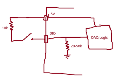

Ill see your paint shop masterpiece and raise it dry erase scribbles:
This is how setup is currently wired. Due to the voltage I was reading earlier I had the equivalent resistance within the Nidaq somewhere in the 22k range. I was contemplating a 2k resistor as it would give me close to 5V and 2.5mA. I can see the risk here that if someone were to switch to output it would have an immediate path to ground. May have to go with the risk based on the fact that when any of our monitoring systems get set up, the nidaq cards gets tucked away and people are too scared to touch it more than power cycling a card.
are you going with the active low approach due to constraints or choice? you can put that NC switch series with the 2k pullup to make it active high and you're safe.

I did this primarily because that is what the 6225 manual showed as a digital input connection. How it acts works well for me though. When the valve actuates, sensor opens, reading goes high. Makes it more intuitive for my techs (and me), I see a high signal it means the component is active.
