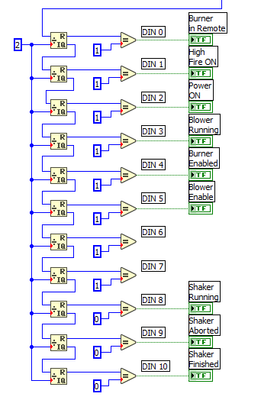

Getting the bits from an integer seems to require a lot of code. I am sure there is a one-liner solution 😄

Not quite a one liner but one Boolean AND per boolean output would work perfectly. Alternatively you could convert it in an array of booleans and then use Index Array, but I'm not so fond of that solution as it is damn easy to mix up the indices, kind of difficult to verify (counting Index Array terminals and translating them to bit position and back is always a chore, error prone and needs to be done every time again when you want to debug and verify the code) and not really less work. The solution with translating it then to a cluster as suggested by cbutcher avoids some of those problems but only if you don't have to many "holes" in the booleans.
And if I program for FPGA, the Boolean AND is definitely THE solution. Anything else will tend to use more resources.

Perhaps to Bool Arr and then Array to Cluster with the appropriately ordered fields?
Renumber cluster elements neatly shows their indices.
In this case you'd need a couple of dummy elements for the unused bits, but perhaps still a reasonable solution?
Yes, that was my one-liner idea. I actually made a draft yesterday but did not post it.
