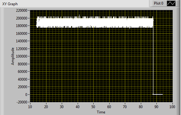

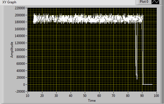

I want to make a very rough guess at the resistance of a switch as it closes, and I'm using a USB-6009 to do it.  A technician was testing these (pressure) switches by monitoring the resistance while slowly increasing the pressure and I was able to identify the ones he identified as "bad" using this method.  Will I lose my Engineer card for this?  I had half a mind to post this to the Rube Goldberg thread, but that's the half I'm using to do this quality work.
I did say "very rough guess"...  But!  It does give very useful results!
Good switch (very clean transition from open to closed):
Bad switch (notice the noisy line where the "good" switch was vertical):

So it looks like you are using P0.0 as a power supply?  Not sure I like that since you are current limiting the digital output.  It would be better if you put a resistor in series with P0.0 (AI1 still tied directly to S1).  You could also use the +5V output of the USB-6009 instead of the digital line.
No.  I'm using that as a digital input to know when the switch closes/opens (so I can record the pressure transducer connected to AI0).  Let me think about your suggestion. Half a mind...

@jcarmody wrote:
Ok, that makes a lot more sense.  And then you just depend on the built-in pull up resistor on the digital input (4.7kOhm to +5V, yep you're good).
