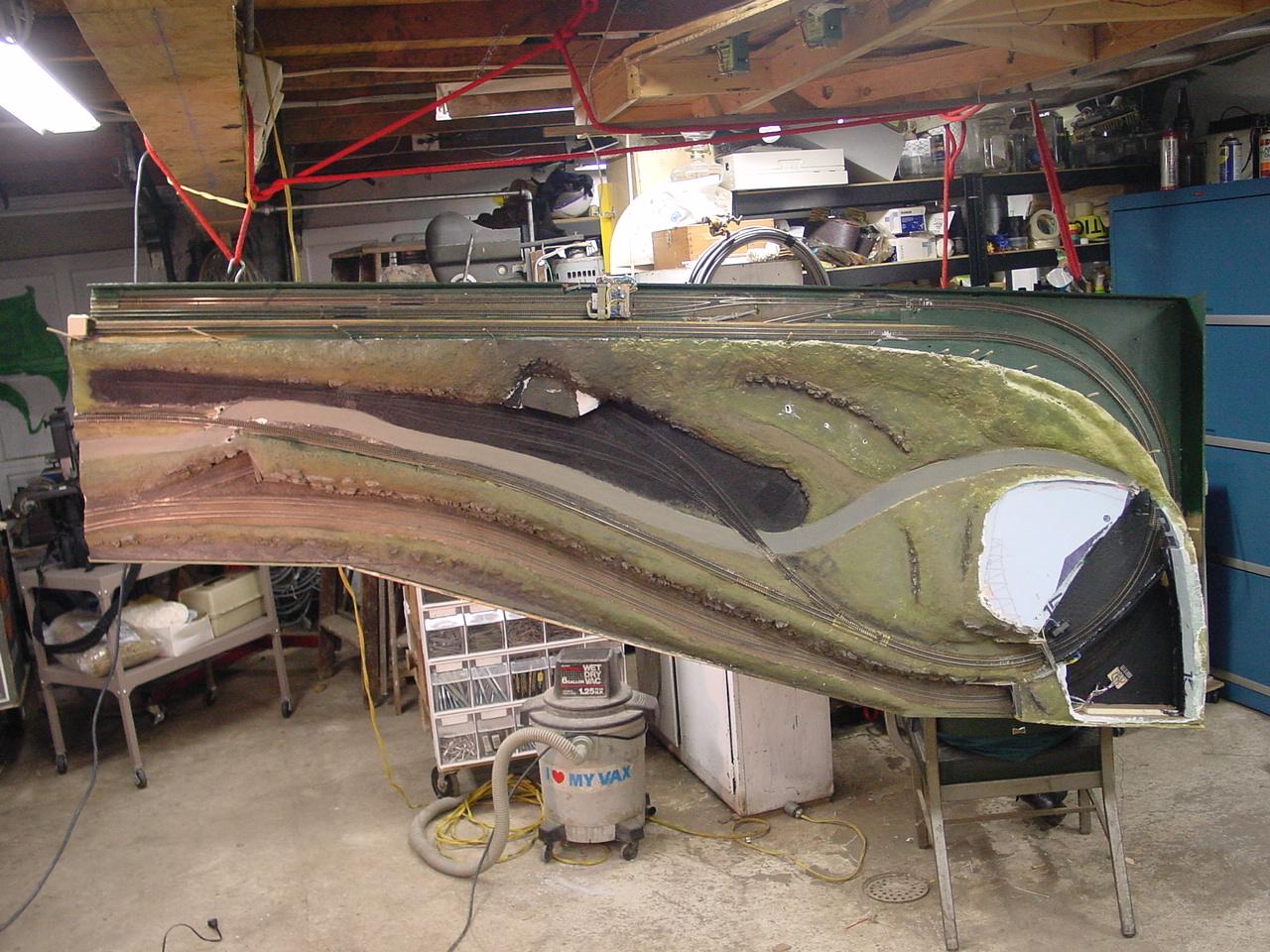

I basically followed the outline I posted earlier and left some of the tedious stuff out. This was a proof of principle to see if i could get a 3-d map together in LV that may work fo rmy train layout. Provided the graph is kept small enough, my laptop seems to keep up OK. In a coulpe of years hardware may be able to run this example with larger graphs.
This is how it went.
STEP ONE Get image.
First I found a jpg of part of the layout when it was hanging in my lab. See "HangingLayout1.JPG".
That image was edited to get just the layout as shown in "HangingLayout9.JPG".
I used this image to define the color mapping of the points in a parametric plot.
This image was just to large for my machine to handle so I used Paint to shrink it down into what is shown in "HangingLayout11.JPG".
My machine was able to plot this image on a flat plane that I defined just based on the pixel location and a constant z.

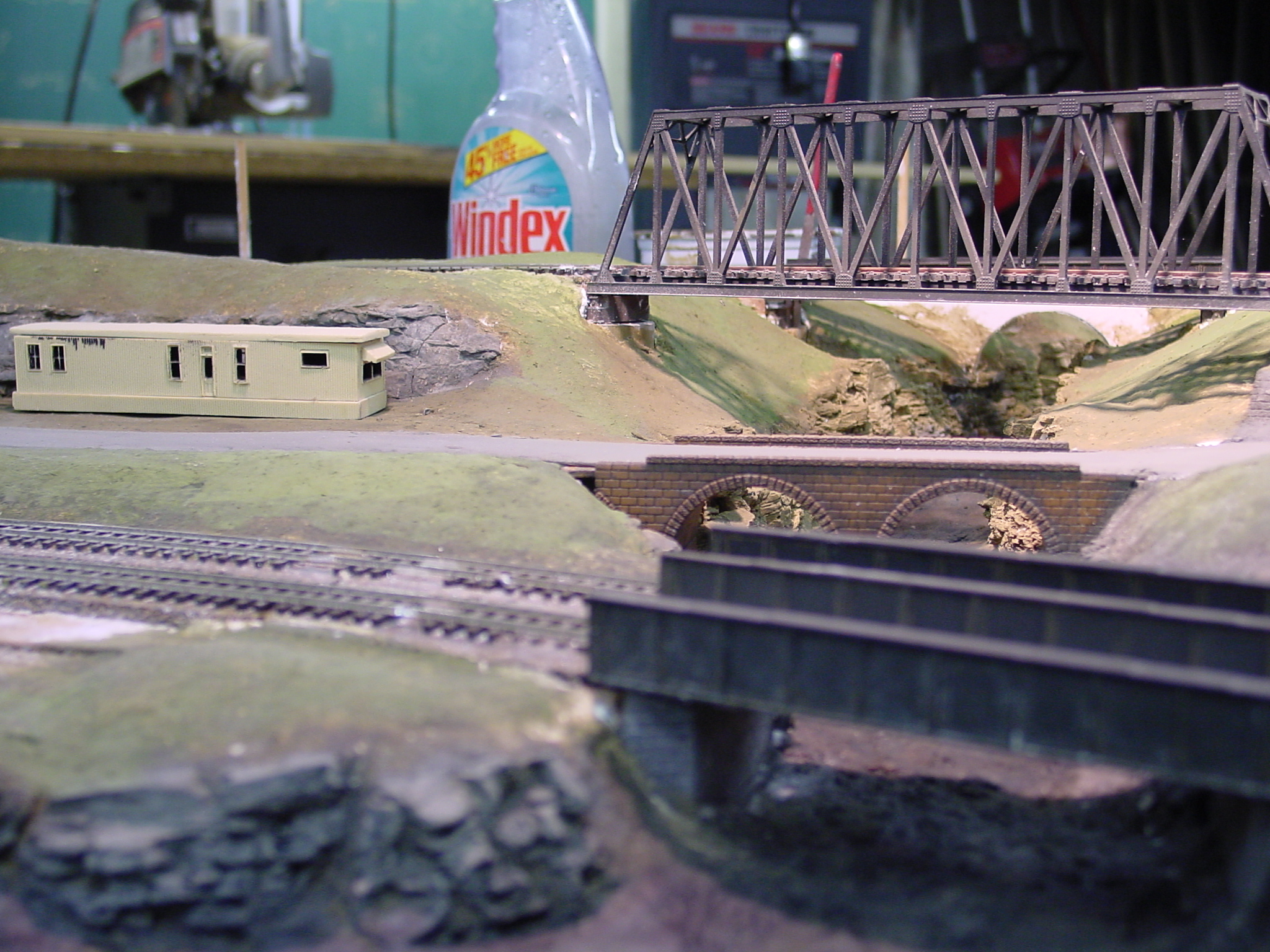

Hi All,
Since the Exchange has now been enhanced to allow the inclusion of images in posts (and because one of my customers was asking...) I am updating this thread to show the images I posted earlier.
See above posting for a discusion of the images as originally posted.
Ben
Right half of layout hanging in work shop

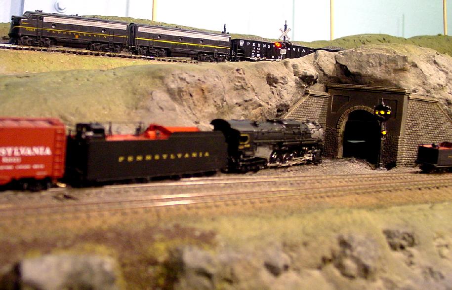

The town of "BridgeVIEW"
