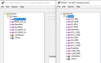

Hello, I'm trying to control and receive feedback for a pump and an actuator for a valve on the same LIN port. Therefore, I tried to combine the two corresponding LDF files to load them on the same port, but it's not working. I can't load them. Could you review my LDF files, both the originals and the combined ones?
I am sending them attached as text files because I cannot send them in LDF format
For the pump "VCU_BEWP_MEWP_V_1_0_0,"
For the valve actuator "PA2634,"
The combined file for both "Sanhua_PA2634."

Did you try to edit the LDF using Notepad? I think it is a bad idea.
My recommendation is to open both files using XNET Database Editor, and then do some manual work.
You can also refer to merge multiple CAN DBs using NI-XNET and make some minor modification for it to work on LDF.
