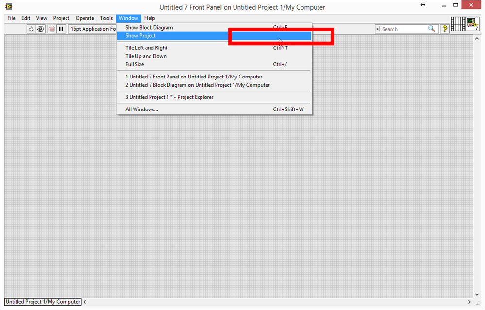

Window -> Show Project keyboard shortcut
We use Ctrl+E all the time to toggle views between the FP and BD.
Now I use single 21:9 widescreen monitor with FP on 1 side and BD on other.
It would be great to have a keyboard shortcut to show the Project explorer.

While on occasion I do want this, what I do use a lot more is the menu item which shows the current VI in the project and that already has a keyboard shortcut (Ctrl+Shift+E).

You can create your own in menu short cuts.

Battler: We learned long ago that there just aren't enough keys on the keyboard to cover every menu item (non-English keyboards often use special key combinations to type special characters and MS and Apple both warn against an app trying to use keys outside of the basic alphabet... LabVIEW accidentally disabled the Euro currency symbol for our European users by using ctrl+shift+3 as a keyboard shortcut). For that reason, the keyboard shortcuts are customizable. We set the defaults to the ones we think are most useful to users. If you think an item warrants a shortcut, you can make that adjustment for yourself. Here are instructions:
https://www.ni.com/docs/en-US/bundle/labview/page/lvhowto/keyboard_shortcuts.html

As suggested, you can assign your own menu shortcuts. I have configured Ctrl+Q to call this menu option and it works really well.
