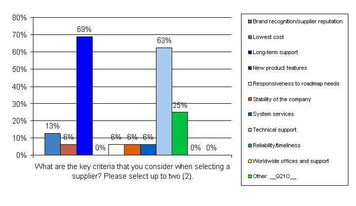

A survey of the attendees at the UK AT-CAB in 2009 showed that long-term support / technical support are the two most important issues, whereas none of the attendees felt that new product features are key criteria for selecting a supplier.
I expect that LTS won't be free but it should be covered in our existing SSP.
