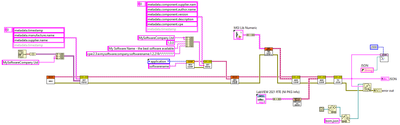

Played with the functions and they do work well for getting all of the .net functions in a specific project. Also, not sure if something like this would be helpful, but you could also do something like this that will find all DLLs in a project and include them as well. I'm curious if there is also a way to pull versions of these DLLs too but haven't had enough time to play around with it.
Message 6 of 30
(5,410 Views)
Almost certainly yes - you can use the 'fileversioninfo' VI(s) to pull the version information from a DLL (providing it's been set by the author). Good shout!
