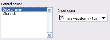

Help to realize this simple program (for example) in Signal Express.
I have 15 waveforms (15 channels), they were read from one uff file (use step "Load from uff file").
For my task I need in first input select one channel (BASE CHANNEL).
In second input select all channels (CHANNELS).
When I take BASE CHANNEL and CHANNELS from different files it works correctIy.
I need take them from ONE file.
When I run ""program pending".

I work in SE:
1. First step - standart step "Load from uff file".
In the output I get 15 waveforms (15 channels - array of the waveforms) from this file.
2 Second step - load my VI (this VI in diagram).
In first input select one channel from array (BASE CHANNEL).
When I run occure "program pending".
Why? It's very simple task.
