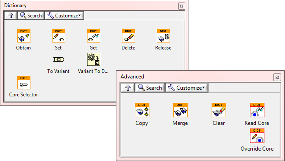

The Dictionary Library enables developers to dynamically define global key-value pairs and access them by name anywhere in their LabVIEW application. The library uses variants when returning values and requires knowledge of casting variants to different data types and handling errors.
The implementation of the dictionary is based on an object oriented plug-in architecture. This allows the user to implement their own core responsible for basic behavior of the library, overwriting the basic Dictionary core class. The latest version of the library includes a human readable INI file core. You can save, edit and load a dictionary from a user friendly format.
The three implementations that are available right now are variant attribute, human readable ini file and binary file.
  • The Variant Attribute implementation is built on top of LabVIEW variants and is characterized by high performance.
  • The file implementation offers the dictionary data type to be stored and retrieved between application executions without any additional programming.

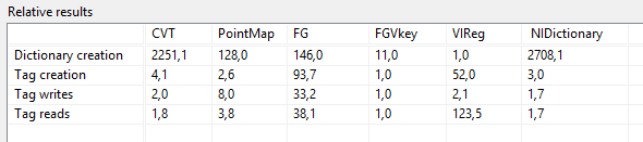

Looking for a Dictionary/CVT type solution for one of my projects I ended up writing a performance comparison of some of the options I found:
Current-Value Table
Point Map
Functional Global with Regular Array Search based Key Lookup
Functional Global with Variant Based Key Lookup
VI Registry
Dictionary Libary
These have all several differences in their functionality obviously (how they handle or not handle different data types, whether you can add or delete tags on the fly - if you need any other reference than the tag,how they are optimized for dynamic vs static tag operations etc.), but the core functionality I tested was dictionary and tag creation, Tag writes and reads (dynamic only (tag not repeates in this case), but I did allow multiple writes in one VI call if supported, as it is in the dictionary API).
The Dictionary Library at first seems very slow, when you just do some lazy testing i the IDE.  One of the main reasons for that though is just that, unlike the others, its VIs have debugging enabled. Perhaps that should be disabled by default?
With debugging disabled and constant folding avoided - in a built application, the Dictionary Library outperforms all the truly comparable alternatives, even the CVT which I thought would be in a class of its own based on more simple testing. That was great news as I was leaning towards using CVT, but had issues with the fact that it does not allow easy dictionary modifications on the fly.
The fastest option of them all is a functional global with a variant based key search, but thats a much less generic solution unless you also make it support more data types (which I did not cover here).
Here is a summary of the normalized results (the values are relative to whatever was the fastest option for the task, so 3,0 for example means it took 3 timeas as long as the fastest option):
Such test results have limited usefulness when the actual test code is not included...but for now I'll just post them without the test code (test code would require all the source code of all the different solutions too so that's a bit messy).

Just to be clear, is it safe to assume this benchmark uses:
-A simple data type like a double so overhead of copying the value is 0?
->I think this would explain the point value map, which has a bunch of other stuff stored with the actual value.
-Uses a dynamic set of names (for example, in a for loop repeatedly reading A, B, C, A, B, C)
->This would kill the advantage of the CVT's caching and explain that result.
Mads
Active Participant
Active Participant
on
That is correct. The benchmarking was deliberately geared towards simple data types and the worst case when it comes to key lookup. If I had used a complex data type and/or static tags, the results would definitely be different. For my current use case that was not so important (I do not need to access one and the same tag over and over again so often that the static access time is critical - but there are plenty of cases where I need to access a large number of different tags with the same accessor.
I quickly rewrote the tests now to use static calls. The CVT takes advantage of caching in its dynamic read/write nodes, but also has a static version which you can use when you know up front that the tags will be fully static...(saves execution time by never even checking if the tag has changed) so I included bot alternatives here ("CVT-dynamicnode" and "CVT-staticnode"):
The Dictionary Library still holds its end. The CVT static node is the fastest in such a scenario, but not by much (on my test machine that is, its probably different on a slower target like a cRIO for example...).
(Note that I have not added lookup caching to the Function Globals here, if I did the variant based one would perform similar to the CVT.)
If I get the time I will create a test that is geared towards complex data types later.  I'm also planning to make a feature table (to have a litte in-house presentation about this whole topic). Performance and its variation depending on the use case is after all just one of many differences.

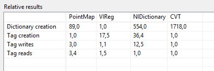

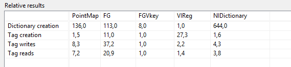

I ran the tests with more complex data types as well (dynamic tags), in which case not all the alternatives support the type.
First here is with a cluster (containing an I32,one string and one small DBL-array):
The CVT does no longer (I was a bit surprised to see) support variant as a data type so it was not tested with this cluster.
Then I tried using a variably sized DBL array instead, which the CVT polymorhpism supports:
That concludes my performance testing for now I think.

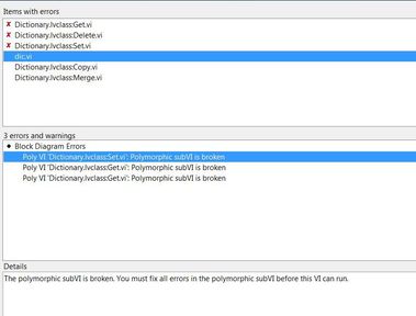

Polymorphic subvi Broken, Am i missing something to install ?
Capture.JPGCapture.JPGpol
