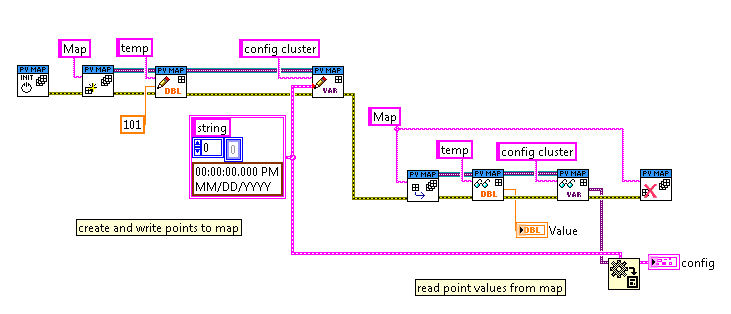

Below is a simple example showig how to write and then read points from a map.

Hi.
When would you suggest using this library instead of the alternatives such as the Current Value Table one?
http://www.ni.com/example/30326/en/
Jack_A.
Active Participant
Active Participant
on
Great question!  Functionally, the CVT and Point Value Map (PVM) serve the same purpose, but there are differences between the APIs.  The PVM allows for multiple maps to coexist at teh same time while the CVT only has a single map.  Having multiple maps allows for more reuse in code since one API could use a unqiuely named map and export the data in the map through an API.  This could live alongside another API doing the same thing.  The example would be a configuration API that manages configuration could store the data in a map and at the same time an analysis API could store its results in a separate map without the two conflicting.  Another big difference between the two are the datatypes that are supported.  PVM supports a few basic datatypes (DBL, string, I32) as well as the variant for more advanced tpyes.  CVT supports lots of basics types but no advanced ones.  So if you have a complex data structure, CVT is not an easy place to store it.
Does that help?
