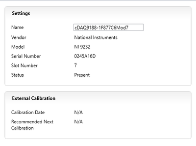

I upgraded the drivers to NI-DAQmx 2025.Q3 and now MAX sees the device as a NI-9232.
I've noticed that calibration info is shown as N/A
Old NI-9232 with screw terminal show their calibration data.
Is this a bug in MAX software?
And, again: what is the NI policy on their direct support for hardware devices?
It could be a bug. I can see the data from NI Instrument Certificate Generator.
I will suggest you reach out to NI Technical Support.
In order to access the technical support, you would need the Standard Service Program (SSP). By default, a 1-year SSP is included with software purchase but not hardware purchase.
See Hardware Service Programs
